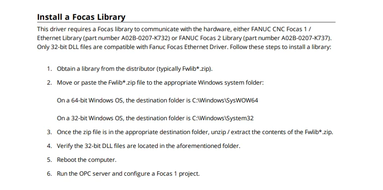

We need Fwlib.zip for Thingworx Connectivity Fanuc focas ethernet driver
We try to using "Thingworx Connectivity" connecting to "Fanuc Robot" via "Fanuc focas Etherner driver"
The "Thingworx Connectivity" report : "Could not acquire library handle for device 'FANUC Focas.FANUC Focas 20'. FWLIB error: 65520."
And we going to read in "Thingworx Connectivity's manual". That must install Fwlib.dll something.
Then, we try to install, But It's not correct version
Where we can download "FWLIB32.DLL (version 1.12.0.2 or later) and FWLIBE1.DLL (version 1.6.0.2 or later)"?

Hi, you will need to get the Focas Library files from FANUC.
From the KEPServerEX help file.
Focas 1 / HSSB or Focas 2 Library
This driver requires that either the FANUC CNC Focas 1 / Ethernet Library (part number A02B-0207-K732) or FANUC Focas 2 Library (part number A02B-0207-K737) is installed on the system. Although the library does not need to be installed to create a server project, the project will not run without it. This software may be obtained from the FANUC distributor or by calling 1-888-326-8287.
Here is a related KB article on the Kepware website.

As far as I know, these libraries are not open source, so you should demand from vendor.
