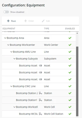

Here is an example from one of our test servers, that has all extensions : AMU, CWC and RTPPM. Notice the Assets (AMU) have their icons and Stations (CWC) have a different icon.
Please pay attention to the configuration guide, in particular to the equipment types, you will need to re-configure part of them. In this case in particular, you'll need to create the Station equipment type for CWC. Some other configurations may be required for CWC (that wasn't needed for AMU).

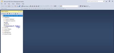

yes, i understand and gone through the documentation as well of CWC and AMU. it advisable to keep same database instance in MSSMS. but what i am saying is in same MSSMS, i will create different instance for CWC
is that works?
or its compulsion to keep same instance
if we keep separate database instance, will it create any problem when data need to exchange between AMU and CWC?

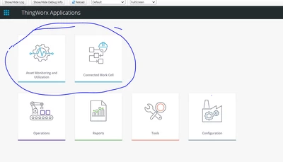

i tried to create separate database as of now on my local system as shown i below screenshot. it went well.
in fact it doesn't shown any difference on UI as well shown in Screenshot below.
I am just trying to check all here feasibility and possible solutions here before installing on actual servers as uninstalling is little chaos.
