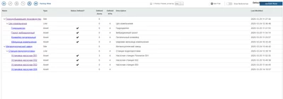

Where data is stored in the configuration and setup application?
There is a standard set of data output to the "Configuration and setup" application.
Where is the location where the data of this application is recorded?
I want to add and display new columns with data on the page of this app.
Jan 20, 2021 9:09 AM UTC
Hi, Do you mean you want to customize the mashup to add additional column to display your asset data? If you please take reference to help center how to customize your own mashup: https://support.ptc.com/help/thingworx/apps/r9.0/en/#page/thingworx_apps%2FCustomizing_the_Apps%2Fcomparing_your_customized_mashups_with_the_default_application_mashups.html%23 Then you could edit the corresponding mashup: PTC.SCA.SCO.ConfigurationAndSetupMashup_ Hope it helps, Thanks, Br, Anna
