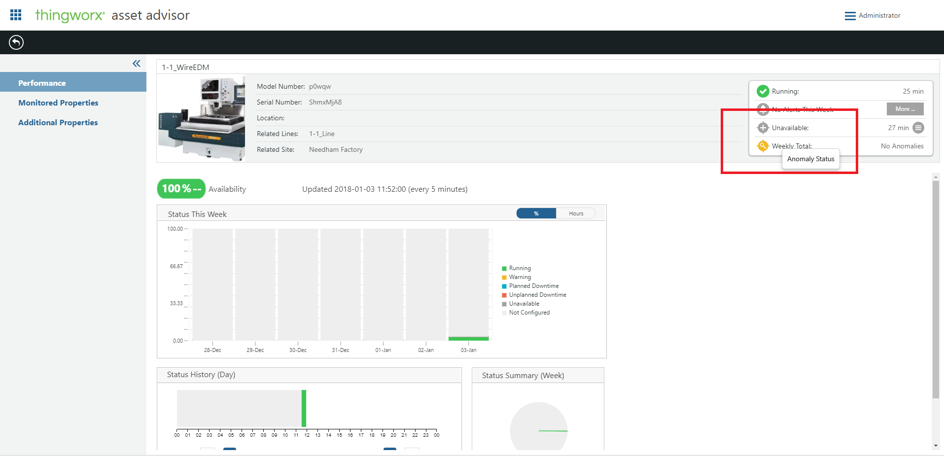

Why it not show anomaly status
I use MFG version 8.0
I would like to do anomaly in asset advisor
What i should to do please suggest me

Greetings Nuttapol,
To use the anomaly , you need to configure the anomaly alert to the asset's property and also make sure all the services are up and running for ThingWorx Analytics Server.

You mean i must install Thingworx analytics server for use with MFG ?
January 4, 2018
MFG installs only Anomaly Detection which are two micro services.
January 3, 2018
Also check your license to see whether you have anomaly detection added. If you are using Freemium version, you will not have it.
