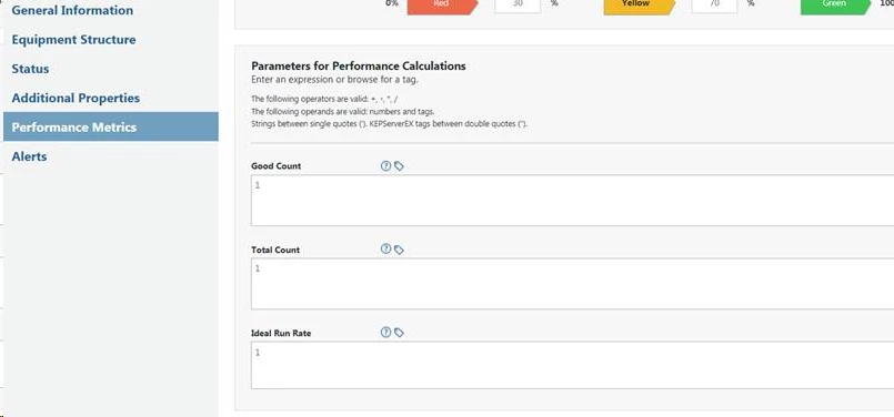

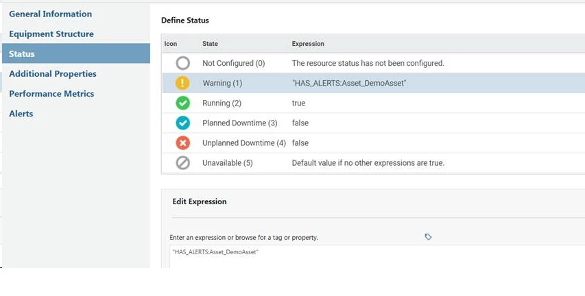

I configured my demo asset as the following

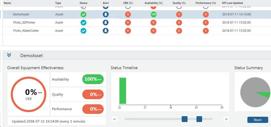

My KPI Calculation Period is 1 minute.
But my OEE,Quality and Performance are all 0
Can anybody tell me why OEE is always 0? I don't understand what's the problem.
Thanks & Best Regards
Tom

Greetings @weli,
OEE is calculated based on Availability, Quality  and Performance
The quality and performance are calculated as :
Quality = Good Count / Total Count
Performance = (Total Count / Run Time) / Ideal Run Rate
From the screenshot I can see that you manually entered Good Count and Total Count in Parameters for Performance Calculations. Can you browse tags for Good Count and Total Count from the Kepserver for this asset instead of providing manual values.

Before I stared this topic, I already read the post you mentioned, and I read the document of how to calculate OEE, but I still don't understand why my OEE is zero. my understanding is:
my good count is 1,and total count is 1,so my quality should be 100%,
Performance=(Total Count / Run Time) / Ideal Run Rate , so at least my performance should not be 0,and since
OEE = Availability * Performance * Quality, my OEE should never be 0.

July 27, 2018
In run time your total count will variate. The total count in this time will be the difference of the old total count and the new total count. If there is no differentiate it will no calculate. At last this is the way that I view it.
About quality I am not sure, but maybe the same things go for it, it has to be a value that changes on time.
Please someone correct me if I am wrong.
You can Override this calculations also to best fit your tags and the way that the company calculates OEE.
