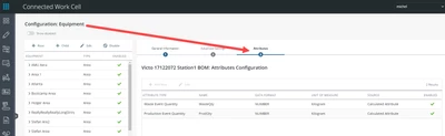

1. I've seen on another post here that I need to configure ProductionEventQuantity and WasteEventQuantity values to a work station, there is any way to see that on the UI? All I see on the equipment tree (Configuration: Equipment page) is name, Equipment Type and parent name. There is a way to see more information on the UI?

Q1 : production & waste quantity. Correct, you need those 2 otherwise you won't be able to finish the execution of your work instructions. Here is what the configuration screen looks like, this example is complete :
Also note you need to select a Subtype in the Advanced Settings tab. If you need more information on this, Here is the documentation link, look at the "Stations" section under the big pyramid image.
