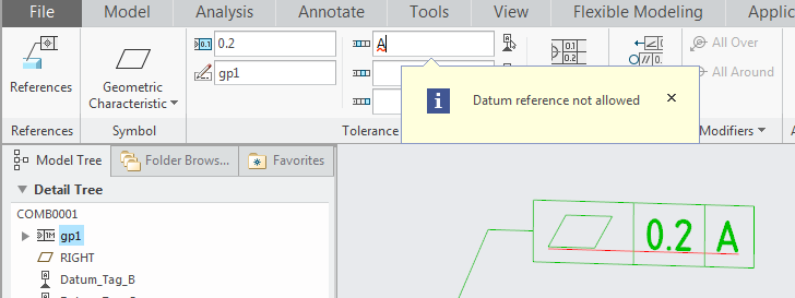

Think of it like a spell check or grammar check in Microsoft Word. It works on GTOL, Datum Feature Symbol and Datum Target. If some of the content in one of those annotations is not correct according to the standard, you'll be notified in two ways:
  1. The contextual ribbon tab for the annotation will display a red wavy underline in the field where the error is noted and a text bubble with a brief description of the error will pop up.
  2. You'll also see a red line under the annotation in the graphics area, which indicates that there is an error with that annotation.
In the image below, I've created a Flatness tolerance and attempted to provide a datum reference, which is not allowed.
The syntax rules will be checked while you're editing the annotation and you'll get real-time feedback on the issues. This means you don't have to complete the task and regenerate in order to see the check results.

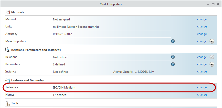

How to set the standard you want to use?
The standard used for the syntax checker is determined in the same way that the standard used for GD&T Advisor will be determined. In Creo 4.0, we are using the Tolerance Standard option that is found under the Model Properties dialog. If you'd like to use the ISO 1101-2012 and related standards, choose the ISO/DIN option. If you'd like to use the ASME Y14.5-2009 and related standards, choose the ANSI option.
As a side note, in the future we do plan to provide an improved option that would allow more flexibility and capability for setting the standard to be used, but for now in Creo 4.0 we are tying this in with the existing Tolerance option.

It's worth mentioning here that the syntax checker available in the base package of Creo Parametric is not the same thing as the full-blown semantic validation that is provided by the optional module, GD&T Advisor. The syntax check is limited in scope to only the content of the particular annotation in question and it does not consider the geometry of the model or any of the other annotations in the check. In other words, the syntax check will make sure that the fields of the annotation are filled out properly and that there is no illegal combination of symbols present, but it will not check that you've picked an appropriate geometry reference or that the datum reference frame being specified is valid. Here are a few examples:
  • The syntax checker WILL tell you that you've chosen to specify a datum reference when one is not allowed (see example above)
  • The syntax checker WILL tell you if you've put some illegal characters into the tolerance value field such as a diameter symbol in a Surface Profile tolerance
  • The syntax checker WILL tell you that you've specified a non-standard name for a datum feature (I, O, Q for instance)
  • The syntax checker will NOT tell you that you've attached a Flatness tolerance to a cylindrical surface
  • The syntax checker will NOT tell you that the datums you specify are not mutually perpendicular
