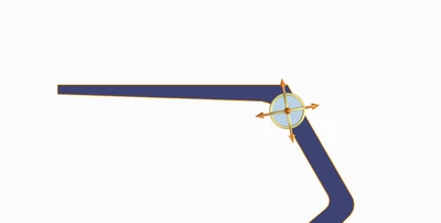

3D cursor is not straight
Im using Creo Elements Direct, when i press this part the cursor is not straight.
How can i change this?
Creo Elements/Direct 20.2.1

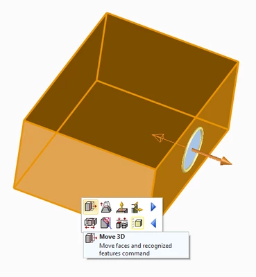

    Select all the part with a box (in fact, doing this, you select all the faces of the part):
    Then click on "Move faces ...":

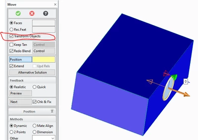

    The part becomes blue because "Transform Objects" is checked (by default). This means that Modeling has automatically recognised that you have selected all the faces of the part and it propose you to move the part, not the faces of the part. This way is in fact the most common case when you select faces in an assembly with a box.
    Since "Transform Objects" is checked, Modeling will move the part, not the faces.

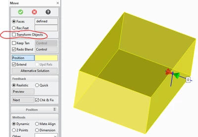

    To move the faces of the part, which is what highway45 is asking you, which is in fact modifying the geometry as he says (confusing because not noticeable, but the geometry will move in its coordinate system), uncheck "Transform Objects". The part becomes yellow, which means that its geometry will move:
    Select the option of the "Move" menu to rotate the faces according to the measurement asked by ThomasKirkman.
    Be careful!
    By doing this, you have changed the geometry of the part, but it is not noticeable. The geometry has rotated in the coordinate system.
    If this part is used elsewhere in the assembly, the part will look as moved.
    If this part is used in another assembly which is not loaded in your session of Modeling, The part will look as moved as soon as somebody else will load this assembly.

    Sep 18, 2024 2:35 PM UTC
    I didnt ask how the part ended up like this!
    I ask how could i make it straight.
    Thank you anyway
