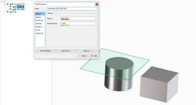

Have a requirement to read the Model Name (marked in green)for every Part/Assembly instead of the Part/Assembly Name (marked in red)

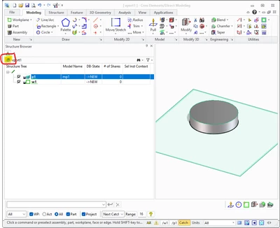

Press [Show details] in the upper left corner of the structure tree.

Tried a few Lisp APIs I saw in the document; didn't help much as none returned the model name.
you are wrong..   because  sd-inq-obj-contents-name is your friend. API naming differs a little from User Interface language, even in english UI.  API differentiate using 'instance' and 'contents' , where 'instance' is shared 'contents'.
