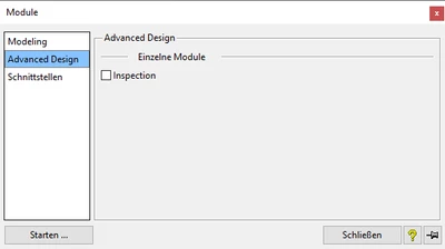

Is it possible to activate the "Advanced Assembly" module in 3D Access in order to play animations? I don't want to change or manipulate animations or relation sets, just play animations.
Creo Elements/Direct 3D Access 20.3

Yes, you can activate the "Advanced Assembly" module in Creo Elements/Direct 3D Access to play animations. Check your licensing to ensure it's enabled, and then use the appropriate playback tools within the software to view animations without modifying them.

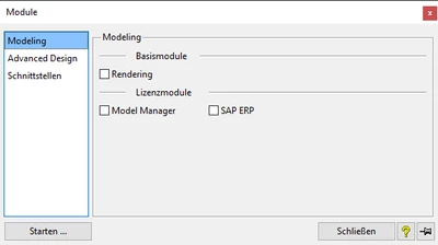

Thank you for your response. I have the "Advanced Assembly"-Licence for Creo Elements/Direct Modeling. Do I need a extra licence for Creo Elements/Direct 3D Access?
My Modules of Elements/Direct 3D Access:
