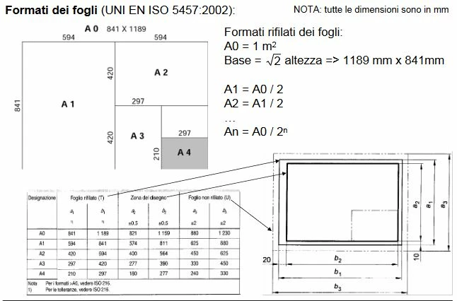

For my opinion, perhaps, the "sheet and the frame in Annotation" are not in accordance with UNI EN ISO 5457-2002. In attached you can find an extract of normative. In particular, the sheet folding references are in wrong condition. What is your opinion?

    I agree with your point. If the sheet folding references don't align with UNI EN ISO 5457-2002 standards, then they could be considered incorrect. It's important to follow the exact guidelines for proper compliance.

    The out-of-the-box frames are just raw templates / examples how a frame can look like.
    They have be to be adapted any way to the customers needs. E.g. the title block, with company logo, a barcode added, etc.   Therefore: feel free to create your own variants and register them to appear in your users interface using function calls of DOCU-REGISTER-FRAME  within your (site/corp/user) am_customize file. Your might want to call DOCU-UNREGISTER-FRAME-ALL before hand.
