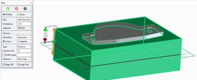

Assymetric extrusion value entering in both direction?
Is there a way to extrude assymetric values in both direction?

Jun 16, 2022 12:13 PM UTC
No, only symmetric.
Asymmetric only in two steps.
highway4513-AquamarineAnswer
No, only symmetric.
