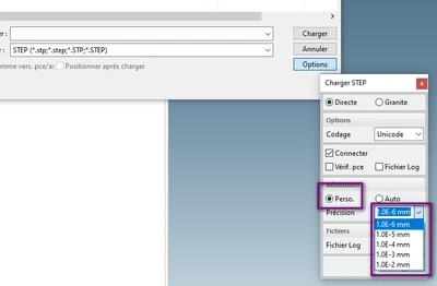

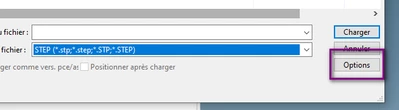

 when importing in STEP you have the possibility to choose to change the resolution of import.
see image below.
The higher resolution you have, the more likely you are to have reconstruction errors .
thank you

Mar 12, 2025 1:21 PM UTC
Thanks!!! It worked!!
