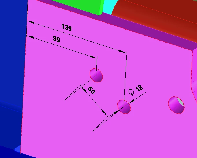

Hello every body,
When I create a 3D annotation in V.18 between two center holes, the new 3d annotation is perpendicular at  the base face of the holes (it is automatically). Can I changue this position and put parallel at the base face of the holes?
I try to do with orient 3D annotation command, but it is not possible.
Any solution?
Thanks in advance.
Regards.

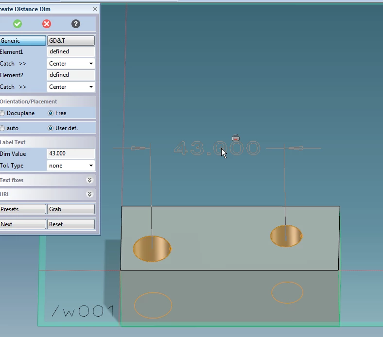

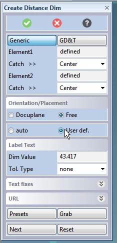

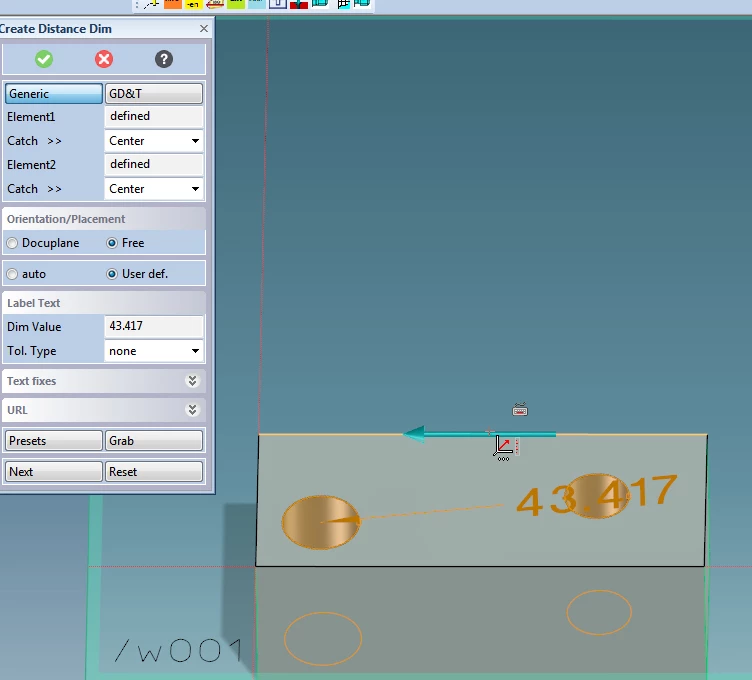

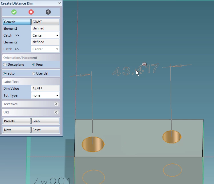

I think i understand the question. You want to pick user def. and use an edge, axis, or other geometry to define the direction.
Tom
Tom
Ed138-GravelAuthor
8-Gravel
Perfect Tom!!!
Thank you very much.
I have to activate first the 3D Documentation Module, here I find your answer (user def.pick).
