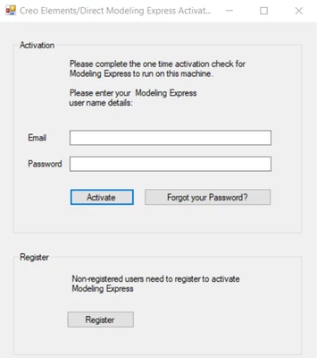

- Click the CE Direct Express icon on my desktop
- Obtain the following dialogue, this is normal or at least has been since direct access to the license server stopped working for me in Nov 2023.  Each time I have to reactivate even though I have an account and have been using CE Direct Express for more than 2 years.  Nothing has changed - same laptop, Win 10 OS, etc.
- I enter my email address and password, select ‘Activate’ to get this dialogue, also normal.

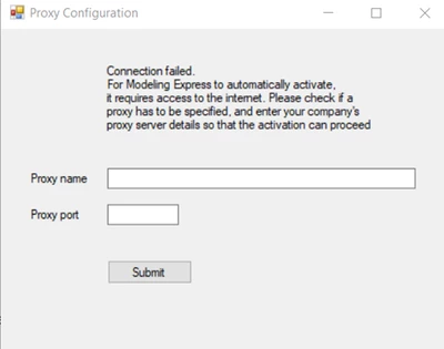

- In my case there is no proxy server, I am merely a PC on the internet.  My internet connection is fast and reliable.  I select the Submit button and obtain this dialogue:

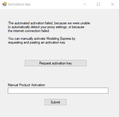

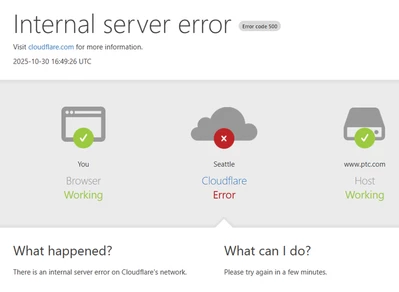

- At which point I select ‘Request activation key’.  Normally I would receive an activation key in seconds, paste it into the Manual Product Activation box and the program starts.  That has changed this week, now I get this:

Hi Thomas,
You stumbled in a problem as few (hundred?) other people as well.
Please read the related topics. The problem is discussed in several topics.
In few words:
  • uninstall all your PE versions,
  • Download and install the PE90  (for download see modeling express in English )
  • for most of the people this have been the solution.
an incomplete list of related topics is listed ==>> here .

Hi Wolfgang
Yes, the installation of CE Direct Modeling Express 9.0 worked, I'm back up and running.  I need to rebuild my custom toolbars but that is typical for version changes.  Thanks for your help!

I have been getting THIS SAME CLOUDFLARE ERROR 500 when I try to use my CoCreate Modeling Personal Edition 3.0 which I have been USING FOR YEARS successfully. But when I tried on Oct. 25th, and the program tries to  request an access code from the PTC server (using:
https://www.ptc.com/appserver/securePeModeling/peManualLic.jsp?lang=en&u=bgmom&m=BETHSLAPTOP&w=6.1&v=30.00 ) it SEEMS that the delay created by the CLOUDFLARE "proxy" causes the PTC server to report "no internet connection" ... which is NOT the case!  Research re. the Cloudflare Error 500 says that IT IS NOT AN ERROR WITH CLOUDFLARE, BUT with the host server ... PTC.COM.  Cloudflare is sort of an "intermediary reverse proxy server"  to prevent BOT attacks and DNS attacks on the PTC server, but it APPEARS that PTC implemented its use WITHOUT understanding that the induced delay "crashes the program" (failure to supply access codes)
PTC offers NO SUPPORT for their free software or EVEN A WAY TO ALERT THEM TO THE PROBLEM ... and meanwhile I am LOCKED OUT of using the program and completing my project!    PLEASE SOMEONE try and get them to FIX it, as I don't think "reloading my old software" will solve it, and my computer does NOT RUN Creo Elements/Direct Modeling Express 9.0 WELL AT ALL!!!
