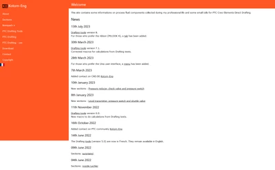

    Oct 13, 2023 7:59 AM UTC
    3D Access is not on my site.
    My site is hosted on one of the 3rd major French internet provider Free (https://portail.free.fr/). Free allows free websites for his customers. It's poor and slow, but 100% free. You can be confident. Here is the index of my little website:
