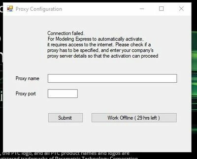

Countdown for connetion
"Creo Direct / Elements Modelling Express"
when turn on my sotware, a label shows me a countdown about the connection. Why? I have some limitations in "Express" version?
Thank in advance

    Sep 16, 2023 5:31 AM UTC
    When you turn off internet on your pc, you can still work with "Express" during 72 hours.
    These last days, I got the same message. Usually, it is a problem on PTC side (unless you changed your proxy configuration). The problem will be solved in some days.
    Click on "Submit", "Express" should start again after a few minutes.

    Sep 16, 2023 2:49 PM UTC
    Hi Kotom-Eng,
    thanks for your answer. I tried to ask an activation from PTC and I have received a code. Now It restarted and I will check the next status.

    Sep 19, 2023 9:03 PM UTC
    Hi guys
    I confirm that the licence of "Modelling Express" is only for 72 hours.
    After them, it must to ask a code of attivation for other 72 hours and I think, that there is not limitations for the number of request.
    I will informe you about other conditions
