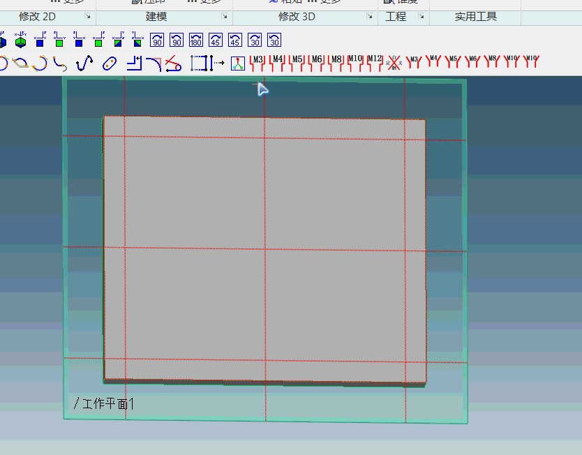

I have a problem about machining counterbore in CoCreate Modeling 17.0..easy for you but hard for me
when we want to create counterbore hole a dialog comes out which needs too many parameters(workplane. counterbore diameter .counterbore depth. diameter.....), it's too intricate and the counterbore hole is standardized..so I make a customized toolbar as you see the attachment, and you needn't input the paremeters above,just choose the point where you want to put......
but here's the problem, I can't find the function for making counterbore hole in IKit...
is there a function or other record lisp like "EXTRUDE"."C_CIRCLE " ect.
PS:  I've viewed too many topics on the website:http://www.cocreateusers.org/forum/ but i have no idea why i can't register on that forum and it's a bit difficult situation about my not well english.
Thanks in advance.

Edit the ma_customize file and replace all the text with this
(load "C:/Users/jerry/AppData/Roaming/CoCreate/CoCreate Modeling 17.0/17.0/MachiningAdvisor/machopts.lsp")
(load "C:/Users/jerry/AppData/Roaming/CoCreate/CoCreate Modeling 17.0/17.0/macros/osd_ma_context_menu.lsp")
(MACHADV_SET_AUTO_MODE :initial_flag_label_visibility :off)
Regards
Tom

I started doing the same thing, but then I found that the machining module table is easy to edit.
I can send you my table, then you can modify it to your standards if you would like
Regards
Tom

Glad to see you here and thanks for replying me so soon.
I've read your answer from http://www.cocreateusers.org/forum/showthread.php?t=8222&highlight=table ,I do as
you said about ma_customize file and customized holes file, but it doesn't work, here's the console window
saying....
maybe it's the problem of my version(17.0?  18.1?  or 19.0?  or my chinese version?)...
besides, what I want to create is more direct..for instance, I push "M3" bottom, and I just specify right
position.  "Hole Diameter","Sink Diameter" and "Sink Depth" are specified as "3.4" "6.5" "3.5", as the .gif attachment

First question, where did you place the machopt.lsp file?
Second question, do you have a corporate customization, or is it just an individual customization?
Regards
Tom
