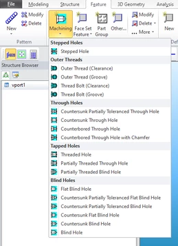

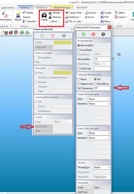

First of all, all the holes have to be done with the machining feature, to the addon that create the table be able to identified them.
In my case i have some tolerance holes, to do that i used a addon that i have that is SolidPower that allow me to set a tolerance to a hole

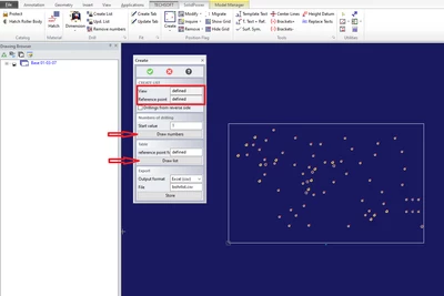

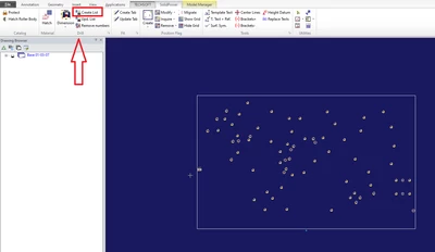

Now, we move to the 2D. Im gonna use the same base for example.
To  create the hole table i use the same addon that i use to create the tolerance hole, SolidPower.
You need to:
-Choose the view
-Reference Point ( Part origin)
-Table position point
Aftter that click draw numbers to number all the holes to be identified in the table.

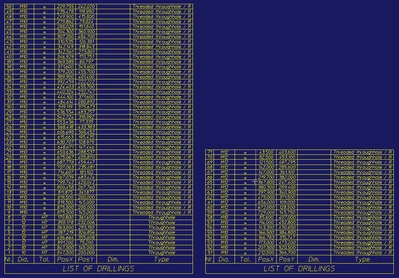

Final step is to draw the table.
The final result is gonna be something like that:
Hope this helps to anyone with this question.
The format of the table can be change (Row and columns width and height, everything....), but that im not very confortable.

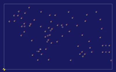

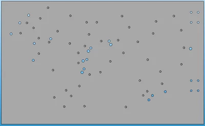

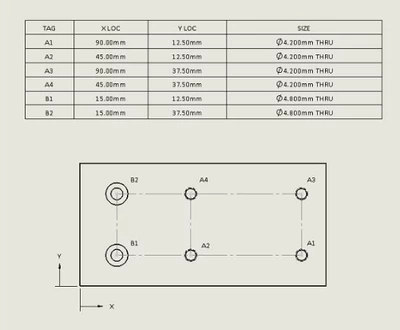

I want to create a 2d drawing of this base  (1st pic) with all the holes.
Normally in this type of drawing all the holes are identified with numbers or letters, and in a table (2nd pic) the location of the hole is identified with the X and Y position from a reference point.
Thanks.
