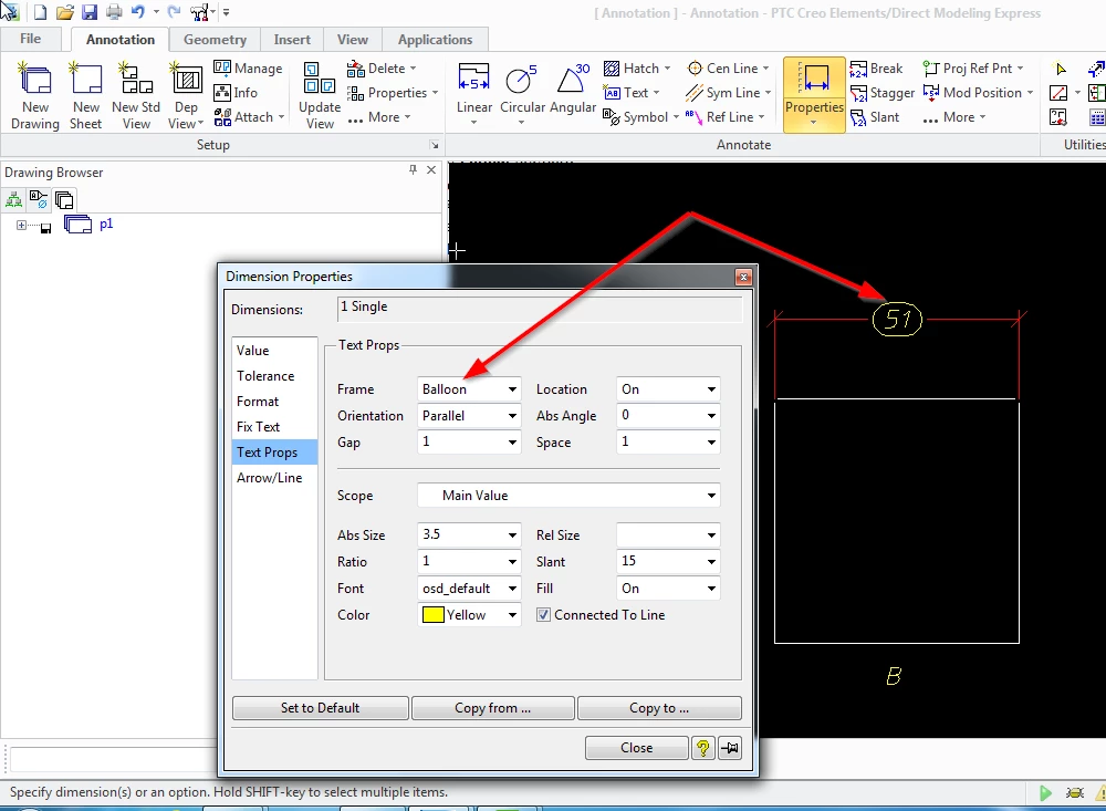

I would like to clear my doubt about the text frame option available in dimension properties.
I would like to know whether the balloon frame which is shown as a closed circular frame is used for the reference dimensions in creo element direct modelling because in standard practice the frame for the reference dimension is of open circular brackets.
Anand
ajadhav-21-VisitorAuthor
March 14, 2019
Need an urgent reply.. supplier has used balloon bracket and he is considering it as a basic dimension. For basic dimension square bracket is used.
Anand
March 14, 2019
The square bracket is the proper Basic dimension for GD&T.  This is the international standard.
March 14, 2019
Thanks sir... So the balloon bracket option available in dimension property is used for the reference dimension instead of the parentheses which used around the dimensions.
