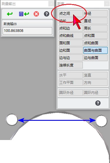

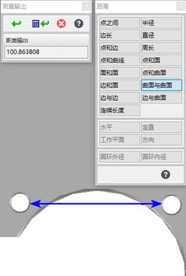

In Creo Elements Direct Modeling 19.0, how can I measure distance between the axes of two holes?
Every time when I want to measure the distance between axes of two holes, I only can get the minimum distance between two holes.

    And you have to take the function "point to point".
    Not "surface to surface".

    Before clicking the circles, hit [CTRL][SHIFT]. That will select the center of the circles.
    highway4513-AquamarineAnswer

    Hello highway45,
    Thank you, this issue had troubled me for a long time, and you have successfully helped me solve it, many many thanks.🤝
