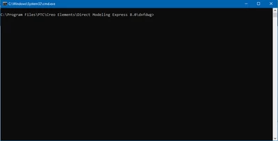

I forgot to tell to uncompress am_2d_0.mi as well. You will get a text file without extension am_2d_0. This is this text file that you should use with dxfdwg.
You should open a command terminal in the directory C:\Program Files\PTC\Creo Elements\Direct Modeling Express 8.0\dxfdwg\
and type in for example:
dxfdwg -o -f  C:\temp\am_2d_0 C:\temp\am_2d_0.dxf C:\temp\am_2d_0.log
