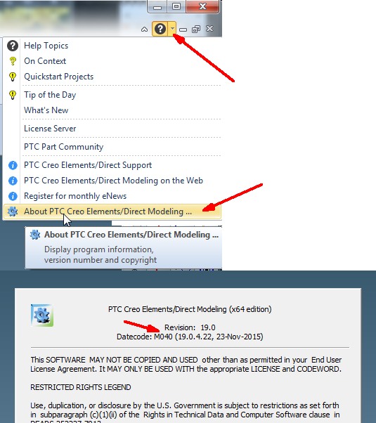

I have version 19 installed on my PC with Win 7. I want to upgrade to Win 10.  I don't know which release of version 19 I have but the files are dated Sept 2014.  I don't know how to find out which release I have.  Do I have to have a certain release of ver 19 to work with Win 10?   Any recommendations about upgrading to Win10?
July 25, 2016
Hi Jeffery,
the release can be found as described in the picture.
Then take a look at the attachment.
They say that version M40 should be fine with Win 10

19.0 M050 has just been released, which includes Windows 10 support.
Please remark that some translators are not supported on Windows 10.
