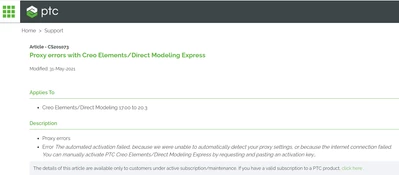

Article - "Proxy errors with Creo Elements/Direct Modeling Express": https://www.ptc.com/en/support/article/CS201073
November 2, 2023
I selected the link, there is no actionable content there.  Possibly because I have only the basic account required to use Express.  Below is what I get.

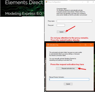

Hello Thomas,
Follow this description
Best regards
Friedhelm

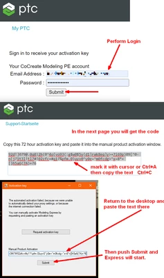

I was able to copy this activation key, which is valid for 72 hours, and paste it into the Manual Product Activation window to use it.
The first time, I was able to use it for 72 hours without any problems.
After 72 hours have passed, I want to use it again, so I do the same thing, but this time a window appears saying that key is incorrect and I can't use it...
April 3, 2025
You can't use a key twice.
A new one has to be created.
