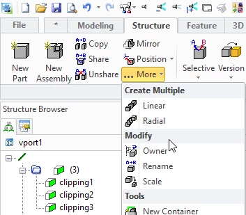

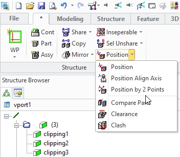

I am working on a custom quick acces toolbar in Creo Elements version 20.1.2.0
I am making 1 tab that contains all the functions i need on a regular basis. And one that relocates my most used functions to the foreground. I wanted to create named seperators like the standard menu does. But I can only find the boring old line seperator.
Is there any way to give my custom split menu a nice looking format like standard? Or is that something that is reserved for the base program?
▼What i've got so far▼
▼What I want▼
If anyone knows how to do this. I would love to know it. Its not completely neccesary, but it would be a nice clean look to a layout that may be used as a standard within the company.

Apr 23, 2024 3:27 PM UTC
Welcome!
I believe you should be able to get what you want by including only a ":label" component in your :contents list. For example (simplified):
:contents
'((:label "item1" :availCmd ("SolidDesigner" "MyApp" "MyFunc1")
  (:label "Separator 1")
  (:label "item2" :availCmd ("SolidDesigner" "MyApp" "MyFunc2")
Does that work for you? Please let me know if you have any questions.

Hello Andy!
I'm based in the Netherlands. So it's almost bedtime for me. But I was wondering about your syntax. Because I customized my ribbon through the Creo Direct customization interface. And I have not yet tried to find the file in which this customization is stored.
But is this just a txt or config file I can add your suggested lines to? If so, I can try that tommorow. I'll let you know if it worked.
Thanks for the reply 👍
Apr 23, 2024 7:23 PM UTC
Not sure about that -- I was thinking you were creating your own menu option using code...  I'll investigate a bit and get back to you...
