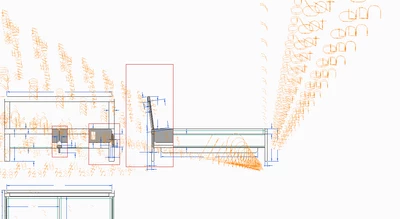

Pozdravljeni!
Imam težave z dimenzijami v načrtih!
Ko pregledujem načrte, ki so bili prej ustvarjeni, imam težave.
Besedilo za dimenzije izgine ali se zmeša. Kako rešiti težavo?
Hvala in lep pozdrav, Gregor

you took over your customization files?  from PE80 to PE90?
it looks in the screen shot as every dimension is displayed multiple times in your view port?
  • how does it look like when printing (e.g. to pdf) using PE90 ..   May be it is 'only'  a graphical / view port problem?
  • how does a new drawing look like?

Hello!
I downloaded the program creo elements direct modeling express 9.0 after I uninstalled the previous one.
When printing and in pdf format, the dimensions are displayed normally.
There are no such problems with new drawings.
Where and how can I download customization files from PE8.0 to PE9.0?
