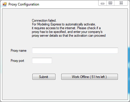

My computer recently changed locations on the company internet. I have been using Direct Modeling Express for several years successfully but now I get a proxy request and warning when I start. It looks like I'll be thrown out after 72 hours?
I clearly have internet access. The company IT support is not sure what type of Proxy information Direct Modeling Express requires. Proxies are not generally used, they say.
Connection failed.
For Modeling Express to automatically activate, it requires access to the internet. Please check if a proxy has to be specified, and enter your company's proxy server details so that the activation can proceed
Proxy name.........
Proxy port ...........
Thanks for any help to get around this issue.

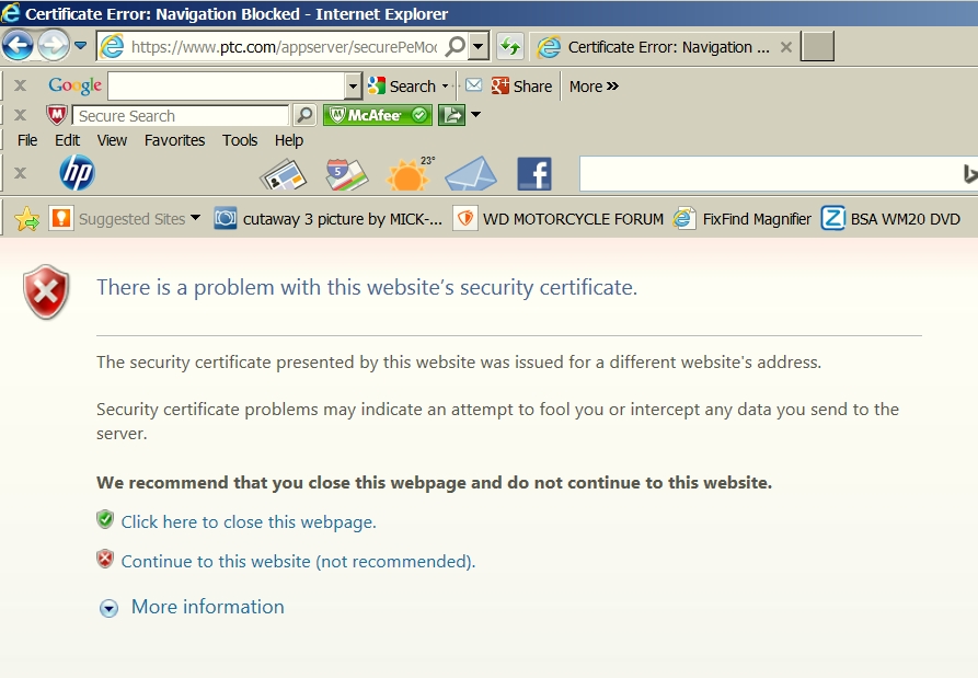

I just downloaded the latest version of Direct Modeling Express, and tried to activate with no luck, it was also looking for a proxy server. I then tried to request activation key manually from the next screen, and got the following error message from Internet Explorer:
Something has glitched for PTC.
Hi there,
it is a bit strange but you have to choose the option
Continue to this website (not recommended).
Then you come to the login page where you will receive the manual Password
that gives you again 72 hours working time.

I too have had this issue. I was trying to evaluate Creo prior to purchasing a full license, when suddenly, it wont work anymore. I have checked and re-checked my machine. The fault does not lie there. I have tried a fresh install on a standalone machine and a new registration, same fault. When logging on to thier site this is successful but I get an security certificate error. I presume that this is the problem but have no way of proving it. I desperation I have tried on several occasions to get PTC's help but have restricted access to support. Published email addresses are bounced and sale will not respond. It seems that they just don't care and are totally unwilling to help in any way. I for one will treat this as the level of support that PTC will give their full product client too and am no longer bothering. Im going back to a company which offers support.

There is currently a general issue with the PTC License Server.
It is NOT something that you can solve at your own.
