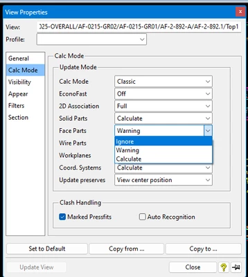

I had this error pop up for all my views when i wanted to update all the views on my drawing. First time having this error pop-up and i don't really know what it could mean. Can someone explain what it is and (if possible) tell me how to fix it without having to redo my drawing. I have a screenshot of the error itself that i will attach to this post. I am working with creo elements/direct 20.6.1.

    I am not sure if this will work, but it is worth a try.  right click on the problem view.  Go to calc mode and change the face parts from warning to ignore.  The same with wire parts and Workplanes.

    This did not work for me but it was indeed worth the try. i had the same error pop-up when i changed it to ignore.
