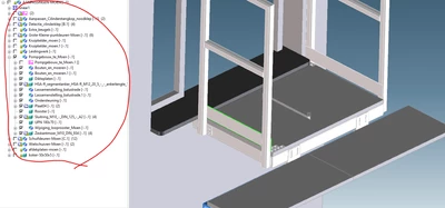

I will try and explain what i want to do. I used to work with autodesk inventor. In that software i could right click on a part/assembly in de model tree (see screenshot) and click "open drawing" and it would open the drawing that was linked with that part/assembly. I would like something like this for creo elements/direct (if it is possible though) either with a custom command or macro or something. The way we do it now is get the masterdata from that part and open the drawing from there. I could save a decent amount of clicks if i could open the drawing directly from the model tree.

a script or custom command could indeed streamline your workflow in Creo Elements/Direct Modeling. While I couldn’t find a specific script for this exact task, you can create a custom command using the LISP programming language, which is supported by Creo Elements/Direct Modeling.
