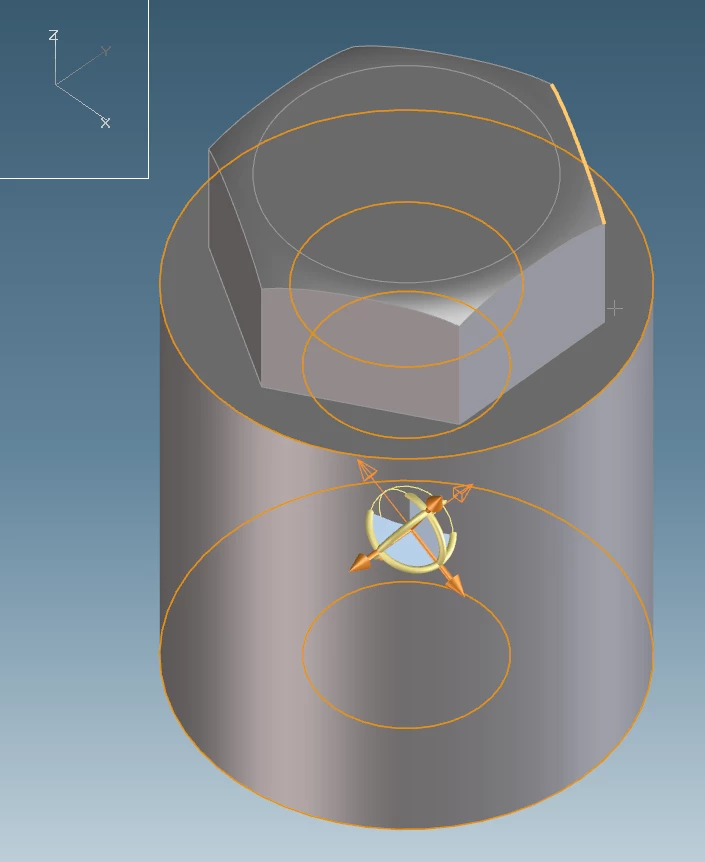

Handles position and orientation
up till now I did not yet go back to the cause of this behavior: I imagine that, based upon the way a part is modeled and possibly moved, it happens that this part, when selected, will show handles that are misaligned with respect to the principal axes (see Handles.PNG).
Is there a way to modify the alignment of the handles associated with a part?
Thank you
Marco

Hello Marco,
I had this case several times. It can be solved.
The issue is, you have a coordinate system inside your part also. If this is orientated wrong, you will have this behaviour.
Can you otherwise share this model? Then i can have a look if i'm correct.

mcielok14-AlexandriteAuthor
Hello Kevin,
model attached.
The structure tree does not show any coordinate system.
Thank you for attention.
Marco

Hello Marco,
You will not see them in the browser, this is an internal "coordinate system". A better meaning to this is the origin of this part with the U - V and W axis.
When you have a look to this parts, you will see that the origin is far away and also turned.
PS: To show this, it's custom code from our firm Savaco
So i placed the origin on the part and in the correct direction and you will see that the 3D Copilot will appear in the correct position.
The "problem" is, this is all custom code, but by default in our configuration for our customers. So i can't give you this code, but i can tell you the real problem 🙂
