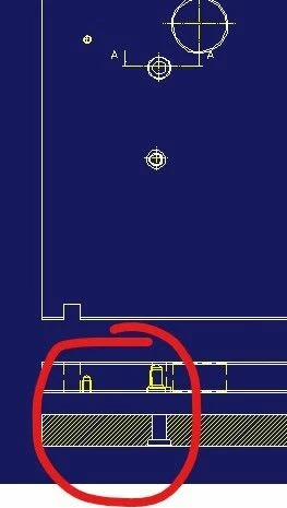

Hole axes
It doesn't put the hole axes in the side views or sections
Why?

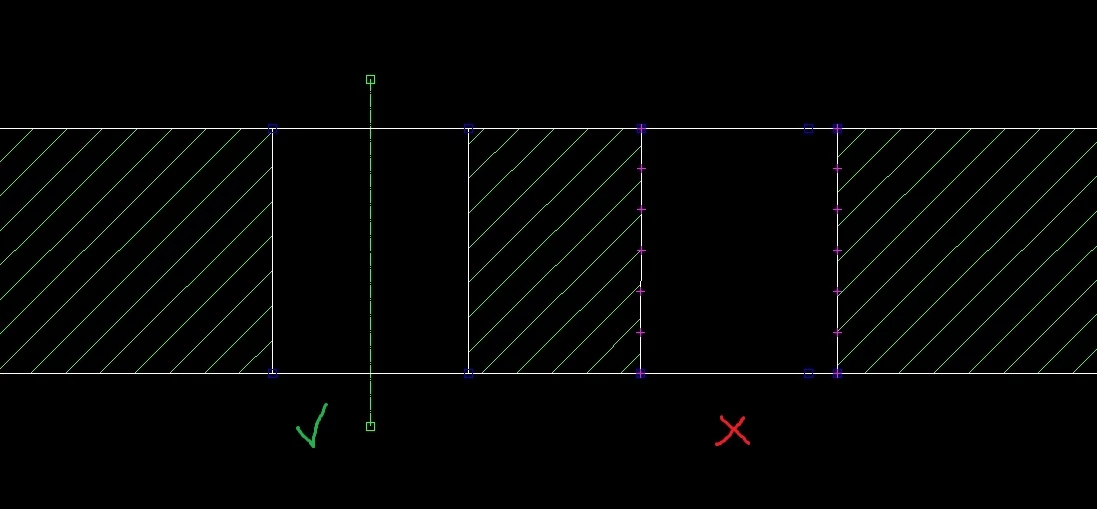

Perhaps the part or the holes are not 100% vertical/horizontal in 3D room.
Or the section views have very small deviations in view angle.
Zoom into it and switch on the edge points (shift+F7).
Pink colored little crosses indicate if something is wrong.

the holes are perfectly perpendicular...isn't it some setting in the sections???
AR_0111-GarnetAuthor
11-Garnet
Apr 30, 2025 3:01 PM UTC
ould it be a resolution problem of the piece?
is it possible to increase the resolution?

The default setting to create those lines is available for  "Add symmetry and centerlines to standard views during view update."  => see settings browser.
a) afterwards it can be enabled / disabled per view. (-> view properties)
b) it also depends on the view-profile which was used when creating the view  / or applied to later on.
BTW  1..2E-1 mm is a rather poor resolution for a system used to use 1E-6 mm. But it the section is defined correctly (center of hole, perpendicular) it should work as well.
