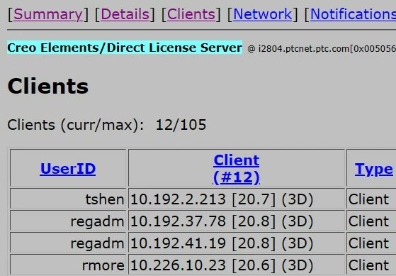

Does anyone have experience about customize Creo Elements/Direct license server interface ?
Customers want to Creo Elements/Direct license server interface show name of user account (same as user Windows log-in name) in Clients tab when client PC using Creo Elements/Direct Modeling (Default show Computer name and ID )
You can see as attached file.
Kindly guide me how to do .
Thank you
James

Put this in your license file:
SHOWHOSTNAMES ON
