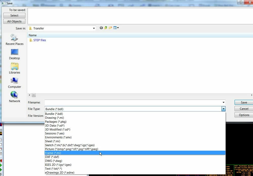

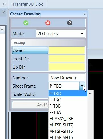

Did the frame show up in the drop down list when starting a new drawing?
When you said this did not work, what results did you get?
How did you create the frame?  Did you save it as a frame?
