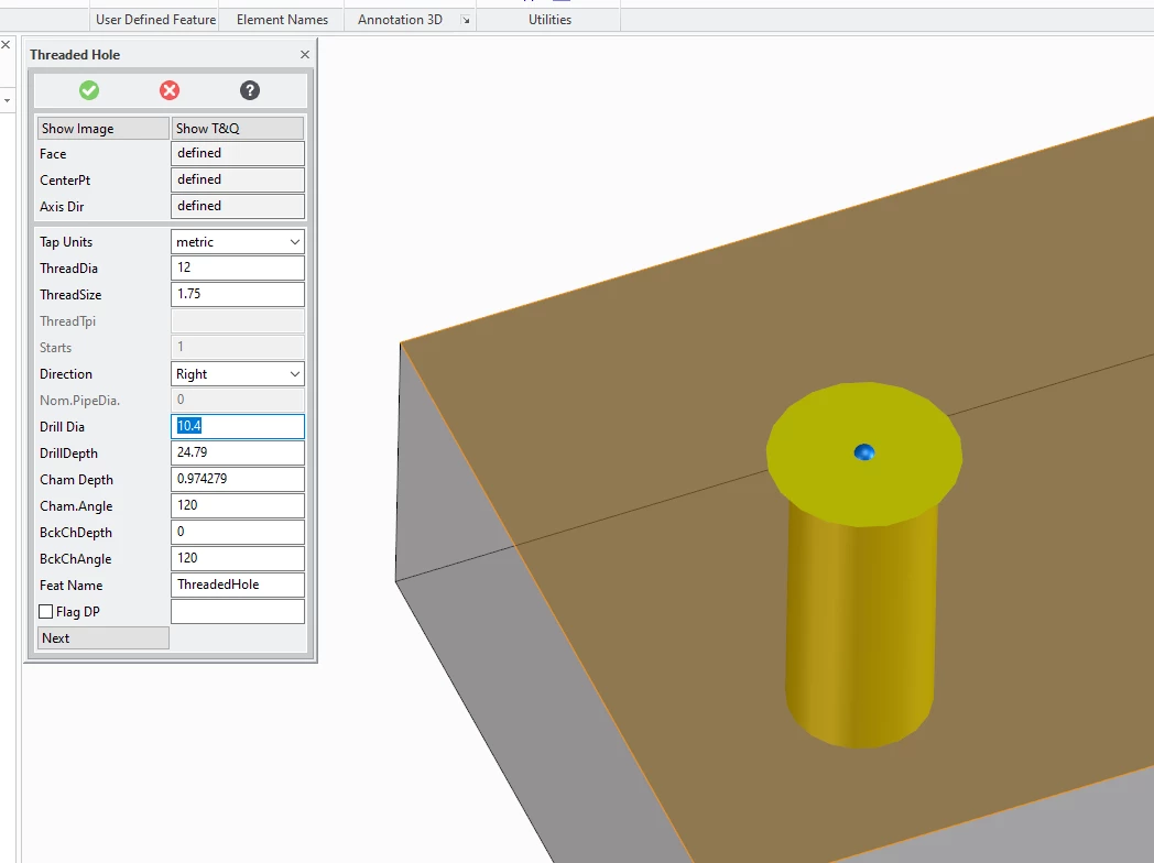

how to change default value of drilling dia?
Hi All,
I have change threaded hole dia standarts. Can I change?
I have looked under sd_customize folder full path is "C:\Program Files\PTC\Creo Elements\Direct Modeling 20.5.1.0\personality\sd_customize\MachiningAdvisor" but I did not see all parameters.
