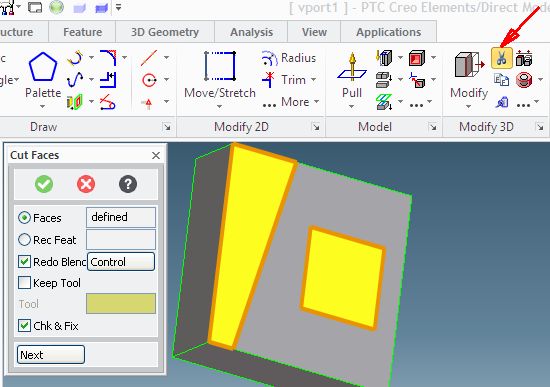

How to erase imprint linear?
Any idea how to erase an imprint linear on a piece?
which commande does that?
    6 replies
    August 6, 2016
    Hello Stephane
    would do it with Cut Faces.
    Push the button in the ribbon, select the surface(s) witch you will get rid and confirm.

    August 6, 2016
    Thx your are the best... any idea where I can find sufacing tutorials?

    I'm more fan of Gary's solution. seems to me the right way to go
