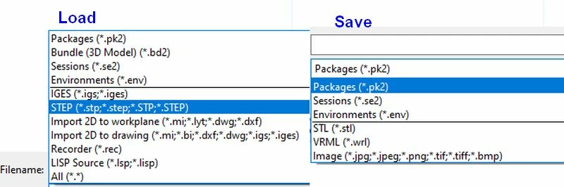

    Hello Nicola,
    what you are describing is very strange.
    The restrictions are intended to prevent commercial use of the program.
    Export of .step would be a function that could be used commercially.
    On the other hand, the user should be able to load external data to show how easy it is to continue working with it.
    I cannot say something about version 8 because I am unable to install it. always abort with error message or the program does not start.
    I have version 6 and add a picture where you can see the various loading + export options that are available there and that work as well.
    Best regards
    Friedhelm
