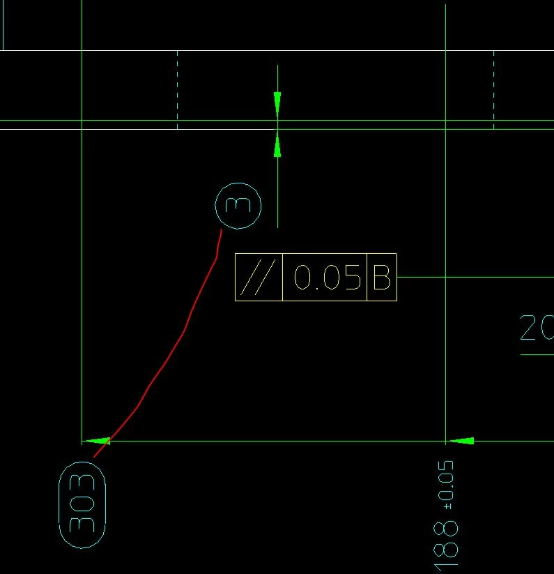

Hello everyone
Could someone give me instruction how to add frame  for inspection dimension in Creo Direct Modeling/Annotation 20.0.

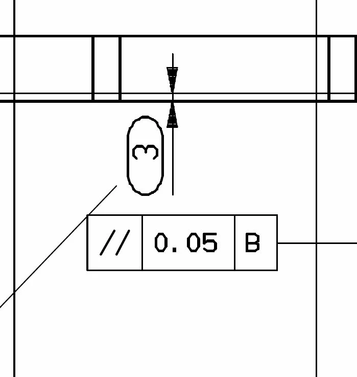

The only possibility I found is to add balloon frame to dimension, but result is not nice and is not work for a single number see picture 1, but wish to have it like a std one see picture 2.

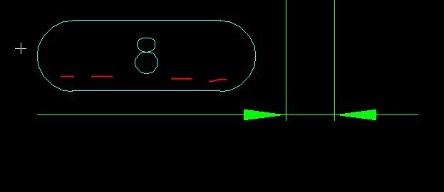

You could add a prefix and/or postfix to the single digit dimension.  If you add a space character, the result  would then be oblong and would not impact the value if you later modify the geoemtry in any way.
utm_20061-VisitorAuthor
August 10, 2020
It helps, but only if i add 2 spaces is not accept 1 space, and result is really ugly.
stevegut1-VisitorAnswer
August 10, 2020
Looks like the command is stripping out any leading/trailing spaces for both the prefix/postfix.
The alternative would be to write a small dialog that would work at the drafting level.  Attached is a simple example using the IKIT interface.  Copy/paste this into Annotator (or load it from a file) and execute the new command single_digit_balloon.  Select the dimension, and a single space will be entered for both the prefix/postfix.  There is no real checking going on here, that would require additional effort.  steveg
