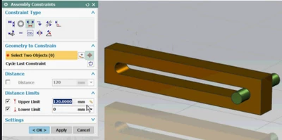

When we work machine elements like cylinder and piston. We need limiting the distance of two bodies.
Is there a way to limiting the distance in adv. design?

One possibility may be to create an variable expression to set a maximum distance.

You can try something: When using "Position" in Adv Assembly there must be a check box for "Stop at clash" and a check box called "Physical". Try to tick one of them (and maybe "Update Relations") and see what happens.
