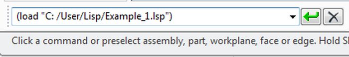

Usually, all your own Lisp files are stored in a specific folder from which they are loaded.
For example, let's take this path:
C:\User\Lisp\...
And as an example, let's take this program:
example_1.lsp
Then it is loaded with this string:
(load "C:/User/Lisp/Example_1.lsp")
Attention, the slash must be "/" and always in brackets
Now there are different ways to load this:
1. Direct entry into the command line:Lispstart.jpg
2. Load when the program is started.
To do this, the above string must be written into a start file.
This is the sd_customize (for 3D) or the am_customize (for annotation).
They can be found in the User Customization Directory.
(File - Settings - UI ... - Customizations - Show Directory)
If it does not exist, simply create an empty text file without an extension.
Example of the location of the setup files:
C:\Users\USERNAME\AppData\Roaming\PTC\Creo Elements DirectModeling xxx\xxx\ ..    (the am_customize in folder ANNOTATION)
( ! This could look completely different in a company network ! ).
After loading, the little helpers can be found in the toolbox
If you still want a toolbar button, ask again.
