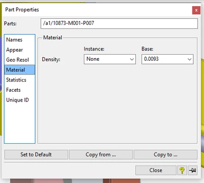

There is no option to emphisize the name of the material. It is insufficient knowledge to enter only the density of material.

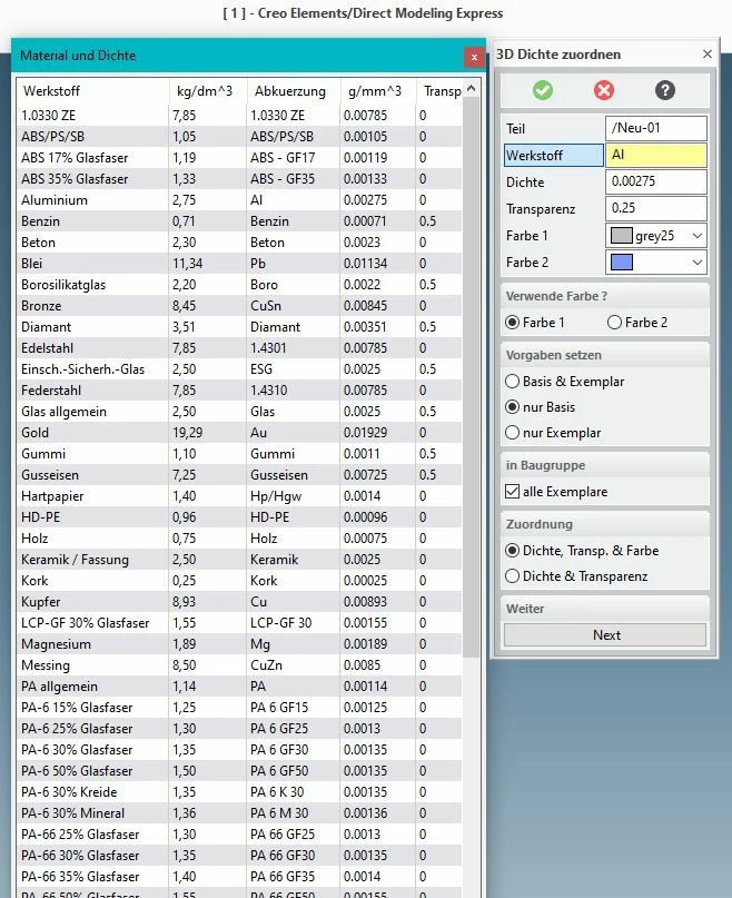

You are true, this proposal for improvement is already decades old.
Usually you should have a table for selection of materials and also be able to design it by yourself.
Could look like this (sorry for german language):
June 16, 2022
Yes I have found that lisp but it must not stay in lisp codes. Creo should make an easy way to use this tables.
