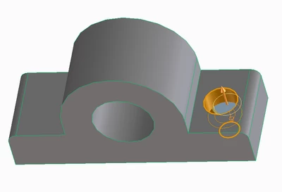

Mirror feature command
There is no mirror feature command

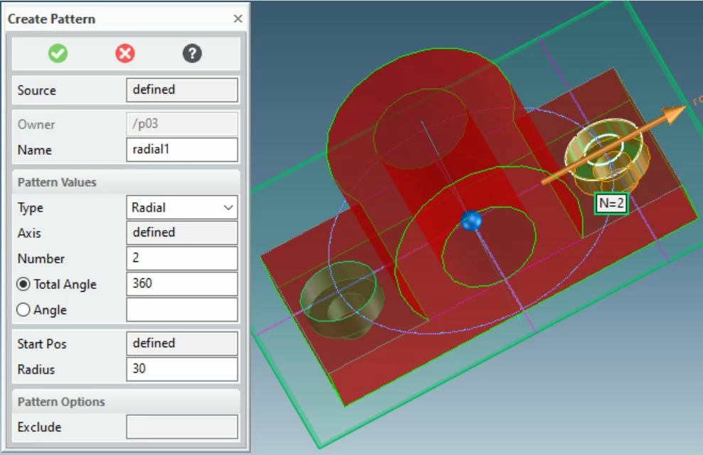

    Correct, there isn't.
    But you can use the normal available functions for that.
    So make a circular pattern with two features.
    Why are you looking for something specific when something else is available?
