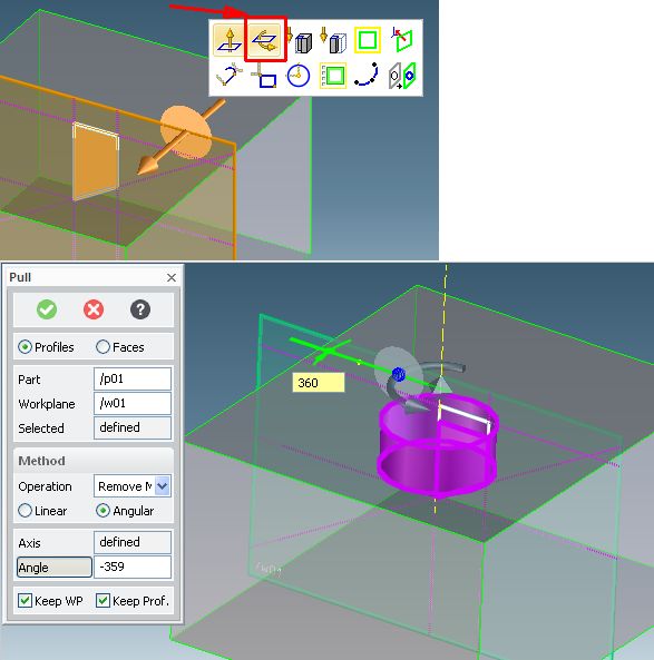

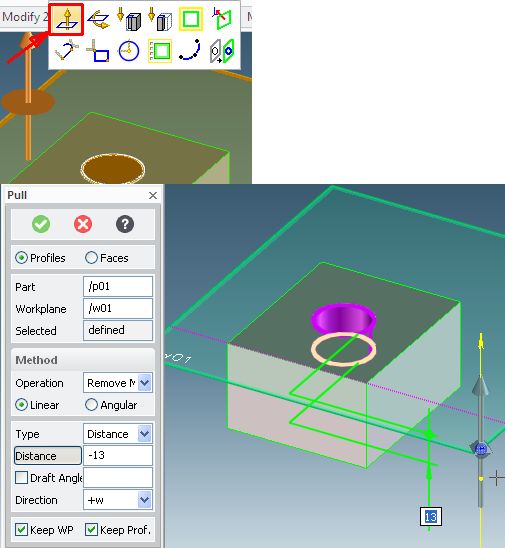

Hi I am new to Modelling Express this seams an obvious question but how do I drill a hole in an existing model. I have an STL from a manufaturer for a simple ABS plastic box consisting of 6 parts the base, the lid and the 4 screws. My question is how do I drill a hole in the base I have created a workplane and drawn a circle but I cannot seem to create a hole in the one side of the box. If I use punch it goes through both sides of the base. When I look online there is only reference to the drill command which is not present in modelling express. So how do I do it?

Hi Jonathan,
Here are two ways to make .to "a hole"
You can use the pull-commands.
Activate the part and make sure that the switch is set to Remove
or
then you have also the cone point of the bore.
Have fun with the program

Click on a corner of the workplane and pull.  If you pull away from the part, the workplane will create a cylinder, if you pull into the part, material will be removed.  Also you can use the mini toolbar and click on the linear pull profile button and a menu will pop up.
