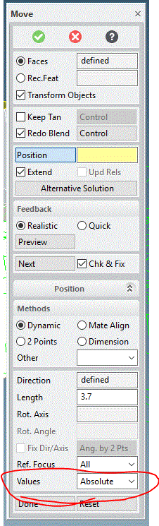

Best answer by PeterKehoe
In the dialog for the Move command (display it if it isn't visible), look toward the bottom for 'Values'. Make sure that it says 'Absolute' and not 'Relative'.

January 31, 2019
February 1, 2019
It solved. Thanks!
