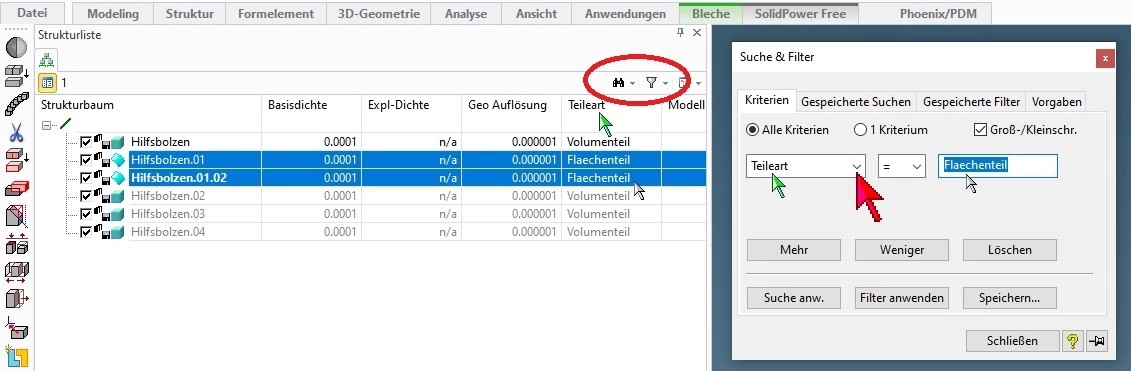

Is there a way to search for face parts in the structure browser?  I would like to isolate all face parts so they can be repaired after import.
Tom
    highway45Answer
    Jan 10, 2024 7:01 AM UTC
    Hi Tom,
    you could use the filter or search functions in structure browser.
    Please see the screenshot, but sorry it's the german version.
    1. Define a filter or search (you can save it later).
    2. Click the pulldown arrow and chose the kind of part.
    3. Then enter the correct text definition for "face part".
    Best regards !
    Matthias

    Jan 16, 2024 2:22 PM UTC
    Thank you!  This worked perfectly!
    Tom
