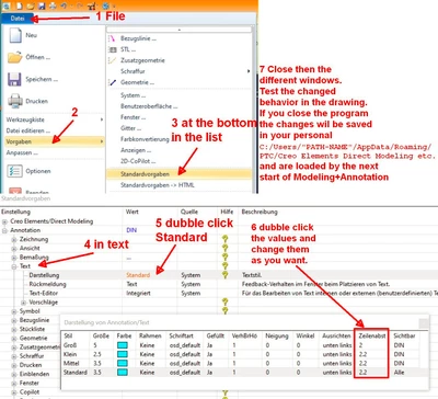

Nov 10, 2022 5:04 AM UTC
Is your question still up to date or have you found a solution in the meantime?
Unfortunately, I currently only had the German user interface available.
That's how I would do it.
Then you should also look here before and after the adaptation.

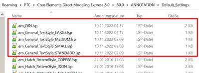

Here the adjustments are saved if you have not changed your "User Customization Directory".
C:\Users\"Your Name"\AppData\Roaming\PTC\Creo Elements Direct Modeling "+What ever"\ANNOTATION\Default_Settings
I wish you a nice day

Nov 10, 2022 8:21 PM UTC
Another remark about the order of changes.
Either
You make changes in modeling/annotation while it is running, then the changes are saved in the files when closing the program.
or
You make the changes in the files before you start the program. The files are only read at the start.
If you change the files while the program is running, nothing happens in the program.
Worse, when stopping the program, your changes in the files will be overwritten .
