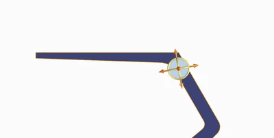

Straighten up the moving part cursor
Im using Creo Elements Direct, when i press this part the cursor is not straight.
Can i change this?
    Jul 10, 2023 5:11 AM UTC
    I think it is good to create a NEW WP + Construction Geiometry in the direction you want in advance and switch the direction of the 3D CoPilot after executing the command.
    Apr 12, 2024 12:44 PM UTC
    How?
    Aug 12, 2023 10:24 AM UTC
    After creating the part it was turned around in the room.
    Perhaps it was startet inside an assembly, but when loaded alone, the cursor follows geometrie.
