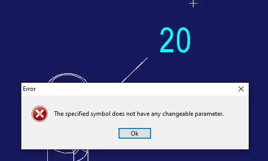

Is it possible in annotation to convert the symbols created as BOM position indicator into texts?
Because in this way they are not editable after having created them on the drawing, not even as characteristics!

    Are you using the BOM module in Model Manager? If so, you can renumber the parts in Model Manager and then click Manage in the insert tab and update the balloons automatically.
    Sep 30, 2023 1:00 PM UTC
    There does exist the command "am_pos_chg_no"  --  in UI: Pos Flags -> "BOM change Position Number. "  This command has the advantage that the BOM number is not only changed in the BOM position indicator itself, but also in the BOM table placed in the drawing acoordingly.
