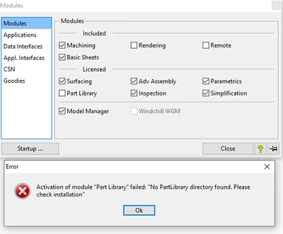

    6-Contributor
    May 3, 2024 1:53 PM UTC
    Hi Kotom,
    Thanks. I did find out through a colleague that we chose to not get this module due to cost.
    However when I looked through the PTC website it looked like it's an extention that is included in the base program?
    But I didn't manage to activate it on my workstation.
    The error was:
    Activation of module "Part Library" failed: "No PartLibrary directory found. Please check installation"
    And not something like:
    No licence for part library found
    So is this extention included in the creo licence, and is it just a matter of setting it up? Or is it a seperate licence?
    We seem to have all modules available besides the Part Library. Which seems weird to me.

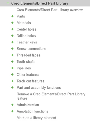

    May 3, 2024 4:45 PM UTC
    Indeed Part Library is not free (it's a nonsense since standardisation is the heart of engineering).
    Therefore, you need a license.
    You need to install the Part Library software as well.
