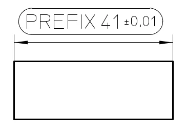

When or where the dimension frame FLAG will be used ?
Does anyone have an idea in which dimensioning type or standard this dimensioning frame is used ?
In Modeling and Drafting it is called FLAG in English
In German in Modeling it is called "Markierung", in Drafting "Schild".
Text can also be marked with this frame, there it is clear to me.
Thanks in advance.

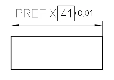

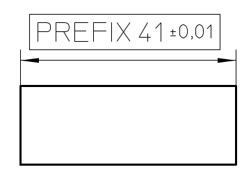

    As far as I know, only the box is needed for basic dimension. Since the entity BAL is common for text and dimensions in the MI interface, I would say that the flag for dimensions has no meaning. Drafting would not block this unnecessary flag for dimensions.
    All what is not in the engineering standards is not blocked by Drafting. For example, Drafting do allow tolerancing a basic dimension, which is a nonsense:
    In the same way, Drafting allows box and balloon for dimensions, which I do not think it has a meaning:

    However, we use the balloon to highlight tolerated dimensions which the people in production have to check regularly and which are also documented.
    So it is not completely senseless for us 🙂
