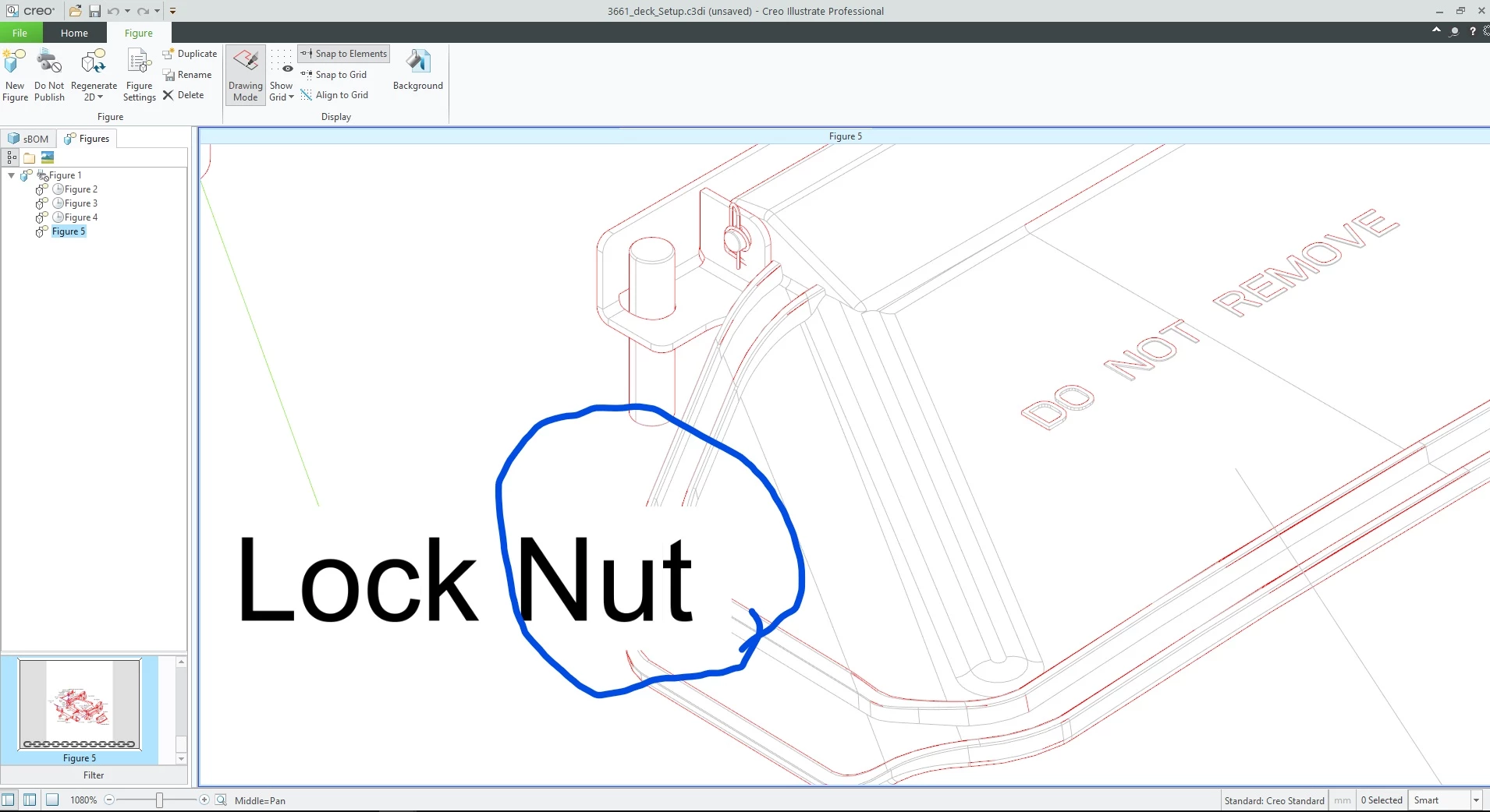

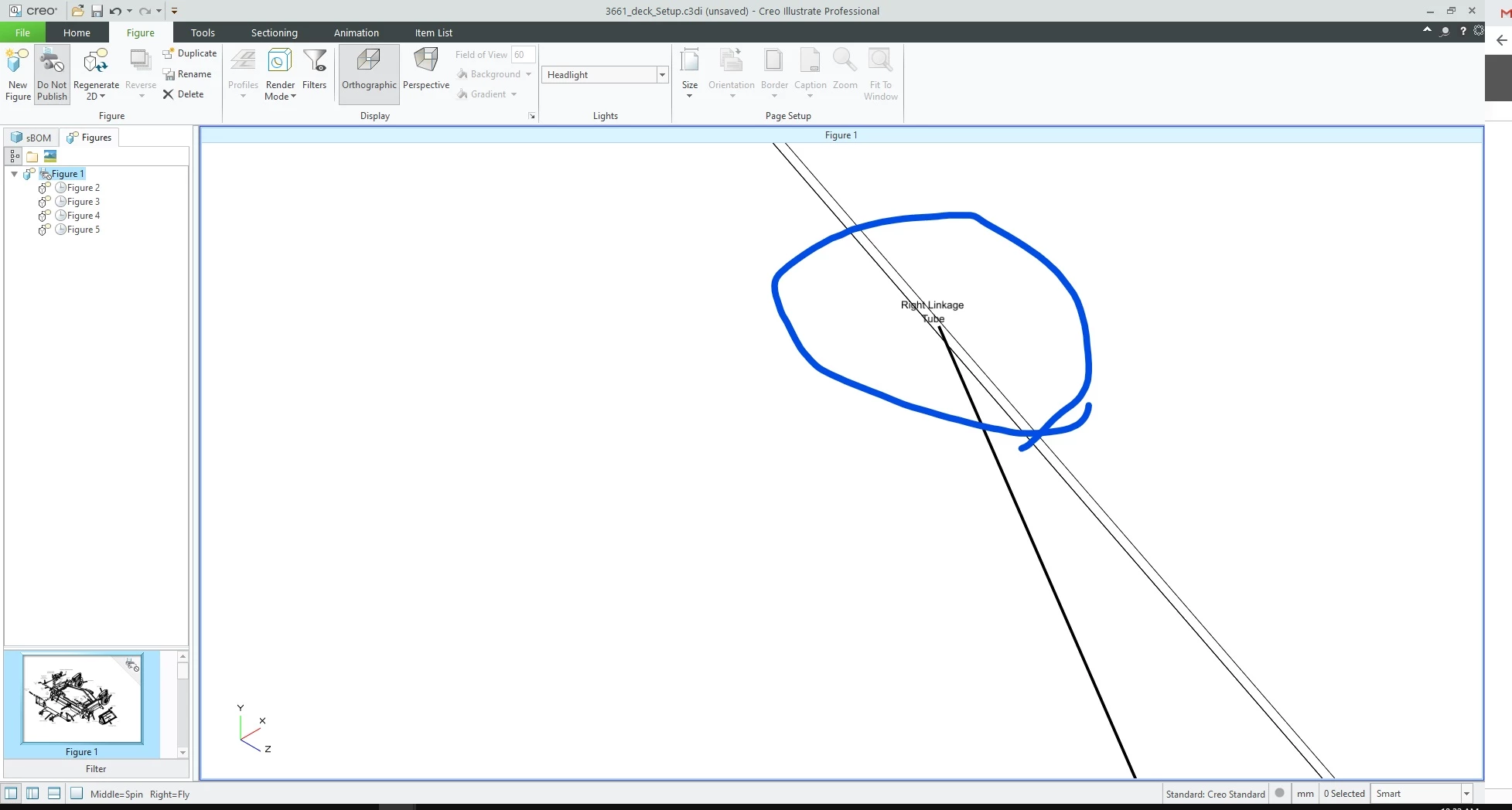

Hi everyone, Im coming across an issue where the call-out has an non transparent box around it in the 2D figure. Is there a way to change this so I can see the lines behind it? in the 3D model on the call-out itself I choose to have no shape and the wording goes across it just fine. Screenshots of both the 2D and 3D included
Thanks in advance!
